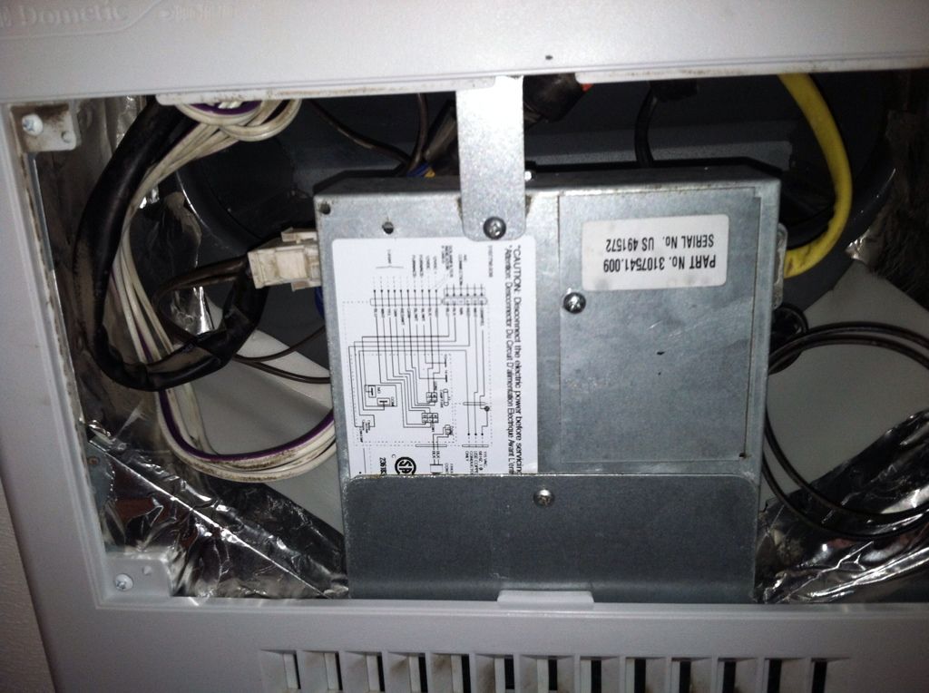

Here is a picture of mine. The yellow is the 120 volts av power and inside the gray box is a relay that is controlled by the thermostat and turns on and off the compressor and fan.

So do I need to remove the box to access the relay or can I merely remove that plate at the upper right corner of the box?

Its only one screw, give it a try, your looking for a low voltage control wiring of a 110 volt switch (relay) It should be easy to ID with the yellow AC cable on the right. Use a meter when its open and see if the 110 is always going through, with thermo high and low positions. The schematic is too small from here but you can ID the relay by the connections and its the only4 wire device on it.
