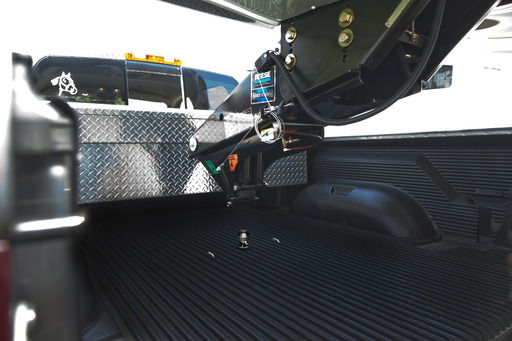

No chains required on that Reese Goosebox I posted. It has a positive locking mechanism. You have to pull the t-handle release cable to unlatch it.

Another choice is to replace the pinbox on your RV with a Reese Goosebox. This is endorsed by Lippert and does not void the Lippert frame warranty. They have an air bag and two shocks. Super smooth ride! No safety chains required. Lots of benefits over a 5th wheel. Only drawback is you have to be right on the money left/right AND for/aft for lining up your truck with hitch.
Good basic video from Etrailer
You need to check into all state laws you will enter into, many states require safety chains with a gooseneck, I have this same box on mine and did the research, lippert endorsed, safety chains required in many states as it is no longer a fifth wheel.
