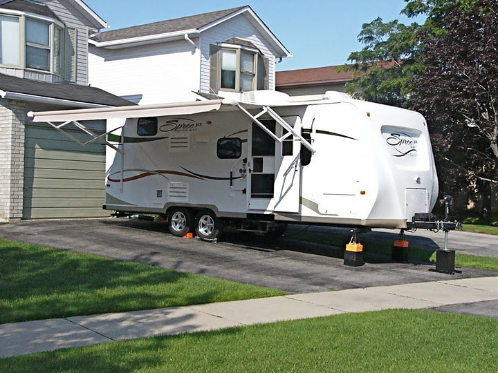

I know on popupexplorer.com forums there is/was a guy name Oz and Us who posted pictures about getting leveled in his driveway:
Click for more images
In fact, I found the thread on it that talks about it:
Leveling on a steep driveway.
