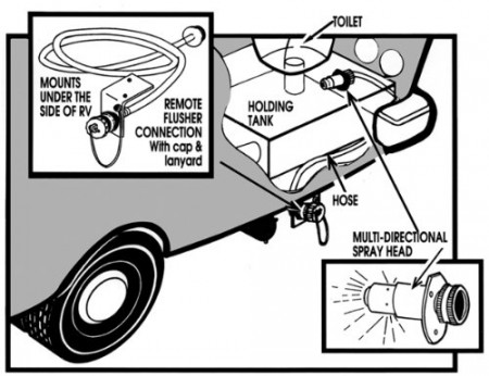

This is actually pretty common... the saniflush nozzle in your black tank is probably same as mine on several different coaches I had,,, Just a plastic cup which is bolted down into the tank with tiny pin holes in it - lousy cheap design but this the most common approach. Those pinholes plug up easily either with tiny debris particles or more likely hard water deposits. Just happened to me on my new 2019 Forester. Having been thru this before, I instructed the warranty service tech to pull it out, drill all the pin holes out a little larger and as before that cured it 100%. Forest River covered it on warranty, but if no warranty it is an easy fix... I did it on two other coaches in years past. See the diagram below.
I believe this is what's installed by the factory in the OP's GT 378 but yes does sound like the tank nozzle is clogged.
