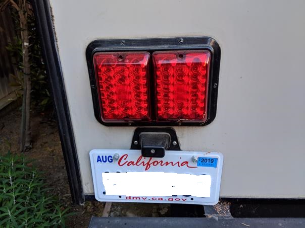

Personally, I wanted to get rid of the crappy housing and I never wanted any corrosion issues with those old style bulb sockets so I went with these. Way brighter than the original housings even with an LED bulb in it.
Too many years of issues with those between boat, utility and travel trailers. Only sealed LED now on any of my trailers. All 4 of my trailers are sealed LED.

Babcock - how do these compare to the size of original lights? What did you have to do to mount them? Any “adjustments needed!
04-23-2019, 10:14 AM
#17
Location: California
Posts: 7,616
Slightly bigger. Just 6 screws and some sealant around the edges. Since they don't have a light for the license plate, I bought a new LED plate mount too.

Are these big enough to cover the original brake light holes?
05-19-2019, 09:56 AM
#19
Posts: 7,616
Yes
