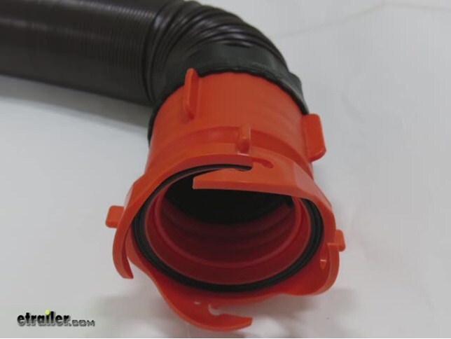

Sewer hose coming off terminal end
On my last trip to the dump, I noticed that the hose coupler with 2 prongs was easily slipping off the pegs. I held the fitting while I dumped to prevent a Hazmat spill. My dealer gave me a Valterra Kit when I purchased the MH and it's worked fine for the past 14 months. So I went to CW and picked up a 4 prong adapter, removed the 2 prong and it still comes off easily. The top photo is the kit and the bottom is the adapter obviously.
Any suggestions?

I now have the Rhino and while the fitting does indeed swivel, I've had a couple of drips from time to time at the swivel so it isn't leak proof either but it hasn't been a big deal.
Check the tabs on your sewer port to be sure they are OK.
Most of the ears on better connectors have a half round spot for the ear to 'snap' into. Such as in the Rhino below.
Yes, I see the difference in mine vs yours. You have a good notch for it to set in, If you look at mine, it doesn't.

Well, I took a good close look at the fittings. The knobs on the MH sewer terminal end are fine. The hose adapter fitting doesn't have any notches, now it does. I took a round file and my Dremel tool and ground ever so slightly notches on all 4 hooks. Now it clicks on. Tested and it doesn't leak, it's snug.
That was scary the other day when I attached the hose to the terminal end and as I place the "L" shaped adapter into the dump station hole, it flip off the other end at the terminal fitting. What a mess that could have been had I started to drain.
Thank for the information.
