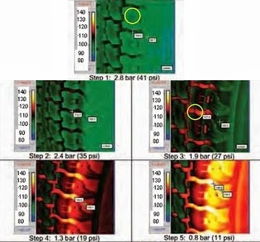

Here is a graphic of tire temperature. Red hot blue cool.
This picture shows temperature variation in tread area
Here yellow is hottest. This sequence was done as an inflation test on a passenger tire but the results are similar for all tires. Lower inflation is hotter tire.
The other thing this picture shows (steps 3 & 4) is the large variation between relatively close parts of the tire.
Unlike metak wheels & hubs if you have brake drag the entire metal object will get hot. A tire on the other hand does not transfer heat from hottest location to cooler very well so if you are interested in knowing how hot your tire is and intend on using an IR gun then shooting the same spot becomes very important otherwise you could get a reading of 105 one time and 130 the next which would not be useful information for making a decision when the tire that read 105 could be closer to critical temperature.
My whole point is that IR guns are an unreliable tool to use on non-heat conductive materials such as rubber.
I suggest that investing a couple hundred in a TPMS for the TT could easily pay for itself if you get warning of air loss.
Just because you check the tire in the AM before leaving the campground is no guarantee of not having air loss 50 miles down the road and ending up with a tire like this.
along with $$ TT damage that can easily exceed the cost of a TPM system.

I knew what you meant, but those photos show it all. Amazing the difference between air pressures. I was always told to shoot the tread and not the sidewalls, and now I see it should be the outer tread.
But I have always traveled with TPMS in the trailer tires.
