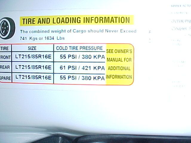

Aspenmeadow, I know the feeling as I bought a Sprinter based Freelander, 24'10".
My GVWR is 11,222# and empty except for 30 gal. fresh water and 1/2 tank Diesel is 9,640#. That leaves me 1,582# and I have already loaded for camping and only have less than 600# left. I can't even tow a smart car.
My next "C" will be on a Ford F450 or F550 Chassis, something that can carry a load. Never again will I be interested in a Sprinter "C".
Marvin
PS, we are in our 70/80's.

Am I missing something here? FR MBS has a GCWR of approx 15,000 lbs.
Why couldn't you tow an 1850 lb Smart car?

Heavens to Betsy, I hope you are right, I will have to re-check the door decal in the AM. Maybe I misread it.
Thanks for the alert but I was under the impression that my GCWR was 11,222#
Marvin
PS, it's a 3500Sprinter chassis.
GA_Boy is offline   Reply With Quote

I think I'm missing something also, I've seen SUV's being pulled behind these and I toll a Ford Fiesta on a car dolly with no trouble at all. So unless your taking the entire house packed into the RV I don't understand. I think someone is doing too math.

I just walked out to mine and checked the sticker. 2014 FR Solera (2013 chassis 3500) GVWR 11030.
GA Boy take a look at this. It might give you a little more comfort. Hope it helps.
Scroll down to the second page.
http://www.mercedes-benz-vans.ca/fil...Data_Sheet.pdf
2014 Solera 24R
USN Retired

As noted in the link above from Mikegjax, GCWR is 15250. GVWR is 11030, so if vehicle is loaded to max (11030 lbs)(including all tongue weight), 4220 lbs available for towed vehicle. Any weight on the hitch (tongue weight) must be included in the 11030 GVWR, as I understand.
Solera brochure link (for my 2012):
http://www.forestriverinc.com/brochu...rabrochure.pdf
Shows the same weight rating numbers, 11030 and 15250.

Here are pictures of my door stickers. I think that my GVW will end up around 10,800#. Will others please post what I can tow 4 down?
Thank you all.
