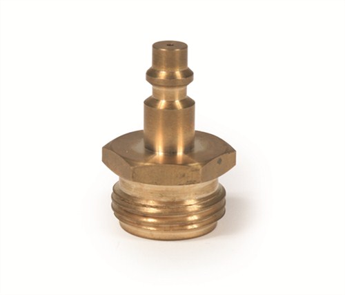

I have a question about that. Do you simply use something like a shop vac to blow (or suck) the water out, or is there a fitting you can buy for a compressor to blow the air out? Also, doing the latter, is there any danger of putting too much pressure on the plastic fittings?
Put a pressure regulator on your compressor and set it for 30PSI.
Yes, there is a fitting that attaches to an air compressor.
You'll want to use a regulator to keep the pressure similar to water pressure, 30-50 PSI.
The reason for blowing out the lines first with compressed air is so that when you then ingest the antifreeze, it doesn't mix with the water in the lines diluting it. By blowing out first, when the pink comes, it's pretty much pure antifreeze, saving having to pump extra through to clear the diluted stuff.

Yes, there is a fitting that attaches to an air compressor. You'll want to use a regulator to keep the pressure similar to water pressure, 30-50 PSI.

Onto what do you attach your air compressor value to begin blowing out the lines? The city water fitting on the outside of the trailer? Does the pump stay off?
Thanks a lot.
Yes, the city water connection. No pump.
There will still be water left inside the pump which can only be protected with antifreeze which is why it's the preferred winterization method in colder climates.
Correct.
The pump will retain a bit of water after the blow out method because it is behind the check valve that is built into the pump. The check valve is necessary to keep city water from filling the fresh tank but by design, it doesn't allow the blow out method to evacuate any water either.
The only way to evacuate that water and protect the pump (short of unhooking the pump and taking it inside your house) is by ingesting antifreeze through the winterization port or one you've added to the pump's inlet.
You'll also want to do another little trick when the pump is on and ingesting antifreeze... and that is to depress the check valve at the city water connection and let a little pink out there as well. Stand off to the side so you don't wear it.
I would caution anyone doing this to the city water inlet. I have ruined 2 inlet valves doing this. For some reason that little ball inside the valve doesn't like to be messed with. Anyway I just blow mine out really well, then add the antifreeze at the pump and call it good. Works for me.
It's always good to know about problems associated with different methods and I'm sorry you've had some problems. Thanks for making me aware of it.
Having done this on many different trailers over the years (not only my own but others whom I've helped) I've never damaged an inlet check valve. I'll need to be aware the possibility exists.
