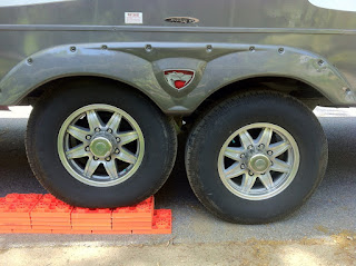

I have a 2012 Palomino Sabre 32RCTS-6 and need to lube my Super Lube wheel bearings. Instead of using a jack to do the job I'm thinking of getting the Camco RV Trailer Aid. I've read a lot about jacking on the frame only and not the axle tube. I only have a 6-ton bottle jack and it will not reach the frame without a bunch of blocks underneath it which doesn't seem like a good idea. I know that different trailers have different spacing between the wheels and would like to know from those who have this exact Sabre model and using a Trailer Aid if it will lift high enough to free the opposing wheel for spinning. They have two models, regular Trailer Aid that will lift 4 1/2" and the Trailer Aid Plus which is supposed to lift 5 1/2". Which one do I go with or will either one work?

If you have the trailer aid use it, if not use the blocks under the tire instead your jack it will work the same.

No. Don't have it yet. I'm wanting to know if it will properly lift my specific taiiler high enough before I get one. I have read on some forums where it doesn't provide enough lift on certain trailers.

Trailer aid claims 5 1/2 inch of lift, should be MORE than enough.

You may need to block under the Trailer Aid - my EquaFlex suspension defeated my 5 layers of blocks:
I had to add wood to it:
For what it's worth- I read the warnings both ways (never jack the axle vs. never jack the frame). I went for the axle with a piece of wood between it and the jack. BUT- I did go out and buy a floor jack for the purpose.
My 32 RCTS does the same. I also use a bottle jack under the axle

I just bought the Trailer Aid and used it to lube the bearings. It worked well and I could remove the tire if needed, which is why I bought it. It did not raise my wheel anywhere near 5 inches. The wheel came off the ground about 1 1/2 inches, which is all I need.

I think the 4 1/2" or 5 1/2" that is advertised for the two models refers to the height that it lifts the good tire of the ground. That then leaves the bad tire dangling somewhat lower. I just want to know if it will lift the bad tire off the ground enough for rorating the wheel to lube the bearings on my 32RCTS.

I did mine with a trailer aid plus, the five and a half inch one, I have torsion suspension, works great.

When the trailer aid did not lift my trailer high enough I still drove the good tire up on it and used a small bottle jack on the axle with the flat. Since most of the weight was off the axle and it was almost hanging, there was very little pressure on the axle to raise it and very little chance of damage to the axle. And it was a lot safer. Just a thought.
I did think of that too. I might try that since it worked for you.
My axle is below the leaf springs, thinking my truck jack could lift the axle.
I have the trailer aid too that worked fine with my TT but now have the Crusader with the EZ-Flex suspension. I'll have to try that, glad I didn't give the trailer aid away.
