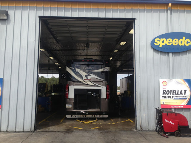

I'm not sure if there are any Speedco's near your location, but they changed the oil in my coach along with the fuel filters, lubed the chassis, checked the fluid levels in the rear and trans, aired the tires to my spec for $218.00. All while I watched...

If they let you watch that is a heluva deal. I'd gladly pay that amount. Freightliner of Arizona did mine for about $236, but I have no idea if they did everything properly. For example, did they grease it?? I got a detailed itemization of what they did, but it was all Greek to me.
When I mentioned I wanted the "initial" 6000 mile service, they looked at me with a dear-in-the-headlights expression. Does not install confidence, does it??
