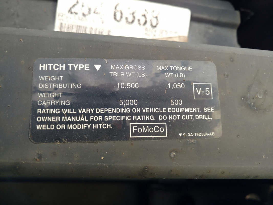

I wouldn't think so, at 1200 lbs tongue weight. This is what my F-150 shows: Max tongue weight 1,050 With WDH
I have tried to rotate this photo but can not. The original is in the proper horizontal perspective. I often wondered how people managed to post sideways pics on here; I guess I know now!

Is this on the actual hitch? If so, then that would be a limitation of the hitch and not the truck, right?
dm6 is offline   Reply With Quote
Thanks ! Been a while since I have seen that sticker.
Which is a limitation of the truck also because the hitch is used on the truck !
Just don't get a setup so heavy that the tongue weight is over 1050.

That 10,500 trailer weight on the hitch actually exceeds the maximum tow capacity of my truck, per the Ford towing manual.
The manual lists my tow capacity at 7,800, as equipped.
Here you go.
[IMG][/IMG]
