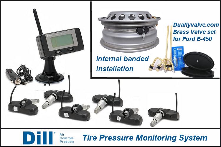

Yep same here... I gave up on using external sensors with the stainless wheel inserts... just couldn 't make it work. First on my Sunseeker and then on my Forester... so I ordered the Dill Air internal setup and works great! I used the banded approach to mount the sensor
1506-453 Trailer TPMS System With 6 Sensors
and then I ordered custom one piece valves
Part # DL1FC Chrome Dually Valve Kit Ford E450 2007-Present, Accu-Pressure Safety Products, Inc.
trouble free and works great...and easy to add air anytime without removing wheel inserts or anything.

I just looked up the dill system, and looking at the picture, it appears to have the same type of sensor as the external. Can you explain what exactly the difference is? Thanks

So the Dill Air sensors are INTERNAL... meaning they do NOT screw on to your valve stems... so there is no chance of leakage, theft or anything else and you do not need to remove them when adding air, which is a PITA, believe me. Been there, done that. There are two ways to mount the Dill Air sensors, either by securing the valve stems to the wheel where they come to the outside of the wheel's valve stem hole like any other valve stem, but the black part stays inside the wheel. But you cannot use this approach with the Sunseeker's stainless steel wheel inserts. Not without removing an insert every time you want to add air and only a masochist would do that more than once.
So you either forget the stainless inserts or buy new custom wheels and then you STILL have the problem with the inside dually. There is just no good way to make them work. That is why I used the banded approach... See the sensor in the photo below mounted on a band around the inside of the wheel. With this approach you do NOT add air thru the Dill Air valve stems - those are hidden inside the wheel. That is why I recommended the extended valve stems from duallyvalve.com which are a perfect fit more or less for Ford wheels on the Sunseeker (and the Forester). These are one piece and require no extensions - they protrude out the holes in the wheel and thru the stainless inserts enough to bve accessible and they include the rubber donuts to stabilize the long valve stems from the inside duallies. It is a trick setup... And then I have the little 12v power display screen on my dash so I can keep an eye on the tire pressures as we drive down the highway.
I hope this explanation suffices... any other questions, send me a private message and I will email back my phone number
Great answer. I did not use the bands and it works just like all the one that are installed in all new cars. Bst way to go and well worth the extra money.

If the Dill Air sensors are mounted internally, how often do the wheels and tires need to be dismounted to replace the batteries?
I am making the assumption that they are battery powered, but I don't know that they are for a fact.

No more often than any car on the road - they all are internal and are basically the same as the Dill one. I have never had to replace one on a car including one car we had for over 10 years.
