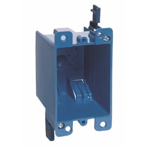

Use old work boxes to mount the new outlets, they work great as the have the "ears" that those junk trailer receptacles have.
Same here. I replaced 4 different outlets and used old work boxes in each case.
