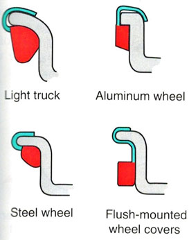

2. If they balanced the tires, the clip on the weight actually can make it leak at that point. This is more prevalent on aluminum rims with lips that require weights with larger clips that make a wedge sometimes between the tire bead and rim. You can usually just remove and reinstall the weight to stop that.
