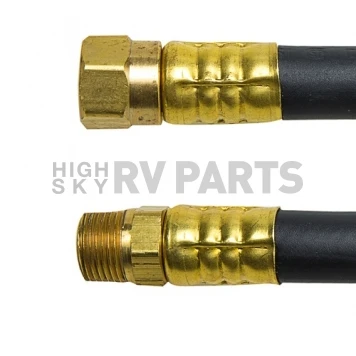

Designed to use a ferrule and be crimped on a propane hose. Much more secure than a hose clamp on the barb.
https://propanegear.com/ferrule-rubb...e-625-ferrule/
Looks like this when properly installed:
https://highskyrvparts.com/image/cac...uct_popup.webp
So yes, hose worm clamp is not safe on a propane hose.

Good choice. Any "repair" you would do, even if a proper repair for a propane line, would create a stiff section in your hose that could cause problems as it needs to flex with the slide moving in and out.
