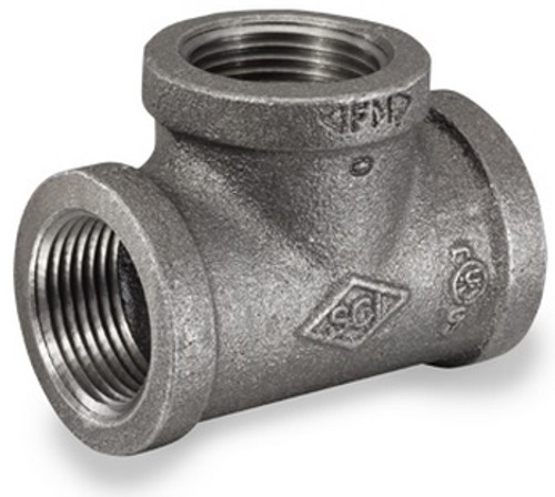

Ok, several dozen youtube videos and internet searches later, I'm leaning towards black pipe, with brass flare fittings at the T's. Checked Home Depot and I can get BP in lengths up to 10' already threaded on both ends for a reasonable price. They have a lot of shorter sections, again threaded on both ends. So I should be able to get a workable setup without having to custom cut or thread any pipe.
So BP threaded into pipe couplers with the proper propane rated pipe dope on the threads with 90* elbows and T fittings to basically make my layout in the diagram that I made for the copper. Then brass to flare on the T's and end 90* with flare soft copper that runs to the appliance ends again with flare. Clean and paint the BP with black Rustolem before final install to give extra protection and use rubber lined clamps as hangers to give some slip but still hold in place. In retrospect this is probably the simplest way to go and I should have made this my first choice. I have pipe wrenches and a flaring tool already so in the end it is probably less expensive also and more durable.
Did I miss anything on this option? Yeah, I tend to overthink stuff sometimes.

Better than brazing in place
This seems like a much better approach than trying to braze an assembly in place. I've done a bunch of copper sweat joints in existing walls and ceilings, and even though I place sheet metal guards in place I'm always concerned about setting the place afire. I can just see you on your back under the trailer, setting it on fire.
