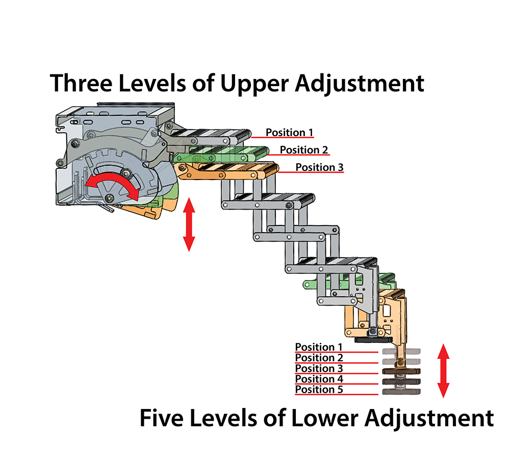

Hello,
Just bought a 2023 Rockwood 2513S. We have a problem. Cannot fold the steps down when parked in our driveway.
they are the 3 step model. Too close to the house to fold them down. No room to park further away unless we want to take out the neighbors house.
Neighbor does not want us pulling trailer forward when loading and unloading as we are on his lawn and putting a dent into his lawn.
Any suggestions on what brand we can replace with?
My other plan is, to put our garden ladder next to the trailer and climb over this to the inside while my husband holds the steps like this. At 65 years old not my favorite option. Still limber enough I could do it.
Thanks

That looks like a 4 step unit..is that right? They do make a 3 step unit. Not sure if that will work for you but it is shorter.
If not from looking at your pic it does not appear they built the box under the door to add the standard fold out stairs.
You might just have to pull it out of the garage area whenever you are ready to load/unload. That would definitely be a pita…

I believe TorkLift has a set of steps that folks buy to swap out the steps you have. The steps solve the problem you have. I believe Torklift shows your problem, but instead of your house, it’s a semi that is parked close enough to create the same issue you have.

Here they are, Glow Step Revolution
https://www.torklift.com/rv/glowstep-revolution

Look at the Torklift GlowStep Revolution Uprising steps. They fold up into the door the way the MORryde steps do but they accordion out so you can use them in that situation.

Torklift has a contact point on their Glowstep page if your model number isn’t listed. You are able to give them your make/model of rv and they check to see if they have a solution.

Your steps will remove with a handful of screws that go down through the mounting plate and into your floor.
The Torklift Steps are a great option...with the stability of the MORryde steps and the flexibility to deploy anywhere...even at different pitches.
Word of caution. The link provided shows Torklift steps replacing the old fashioned collapsible steps...in which there is a structure attached to the RV frame/floor that holds those steps. Make sure that the Torklift steps you choose are made to replace steps that do NOT have that structure. The Torklifts must be able to attach to the floor and/or frame of the RV.
Note that this picture depicts Torklifts either using that existing structure or having its own, similar structure.
ON THE OTHER HAND, if your rig has that under structure for conventional steps (a vestigial component that's not used), conventional steps would also be an option. I replaced my conventional steps with MORryde steps, so my structure is still there.
Finally, you may be stuck with adding some sort of threshhold where the MORryde steps covered the joint between the floor and side-wall and door frame. My MORrydes fit right over the existing threshhold, but yours came from the factory that way, so you may not have a conventional threshold. Perhap the Torklifts include one, or you could buy something at the hardware store.
I'm sure Torklift can handle replacing the MORrydes, but be sure they know what they are replacing. And you may need to do some significant drilling if the conventional step frame is not there. Sure, vestigial holes for a conventional step may already be in the frame...if you're lucky. But if the conventional step mount is gone, the holes may be, too. Yes, anyone can drill, but you may be drilling 1/2" or larger holes through the RV frame. Not a big deal, but this may be beyond the capacity of a cordless drill. If so, you may rent or buy a 1/2" corded drill, a couple good bits of the right size (because it's easy to break them), and read up on using oil when drilling in metal. You'll also need a handful of 1/8" and 1/4" bits to drill pilot holes...again spares because they often break...especially as you are breaking through the steel. Finally, be sure to have the side handle on the drill, because when you're drilling a 1/2" hole in steel and you break through, the drill wants to break your wrist. Don't forget eye protection from all the drill shavings. Of course, you could get them installed. If someone agrees to do it for $100, jump at it. But I digress.

Thank you for all this information. I do think I will have someone install. Husband can do some things. This might be out of his comfort level.

We had the same problem and replaced with the Torklift mention above. They work great and folks at the factory were easy to work with.

I think you may just be able to remove the steps by pulling the 2 pins on the piano hinge and use a step stool while in the driveway. They are exposed with the stairs in the up position.

You can buy the removable hinge for your 1st gen steps.
https://www.morryde.com/products/ste...e-hinge-plate/
