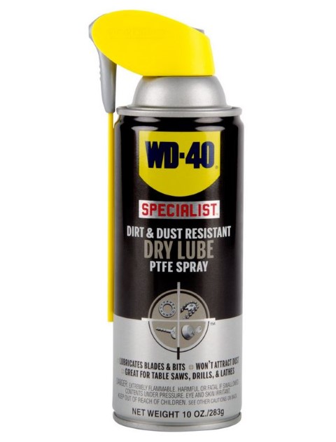

Old 02-10-2023, 08:07 AM   #6
Posts: 17,132
Originally Posted by Montana View Post
The first couple steps fold ok, then everything acts as one unit and won't go up into place under the threshold
Thanks for your response
Spray dry lube on the side slots and slide pins made ours slide up into place easily.

Old 02-10-2023, 09:19 AM   #7
Silverback Guy
Join Date: Feb 2017
Posts: 34
Thanks,
But like I mentioned in my post, I've lubed everything already
