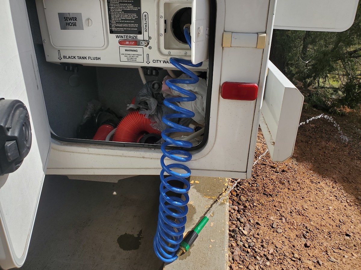

I can't find a drain for the fresh water tank.
Looked in the obvious area where the black and Gray drains are and all I see is fill ports to flush the black and city water winterize FILL PORTS

OK I have a problem I cannot locate the fresh water drain valve.
I have bad water in my system and we are camping and I need to drain it as soon as possible!!
Been crawling around on my back been looking for over an hour.
I did find this but it has spray foam all around it with no pet cock.
Ended up using the spray nozzle feature in the back but had to run the water pump the whole time not sure if I could overheat the water pump but I know this is not the right way to do it but was able to drain a tank.
thanks.

The blue tube you pictured next to the tire is the drain. The valve should be located in a compartment above the tube.

Turns out it's between the step and storage
Underneath two hoses red and blue.
Spent most of my day dealing with this what a pain in the ass..
So I drained out the water that was in there put in some water from the campsite put in some bleach 2 cups and drove around not very much though and drained that.
So I'm back at camp and used the the city tap water to fill it backup and also put in 2 more cups of bleach.
It still has a foul smell coming out of the kitchen faucet I thought it might be the drain put some bleach down there but still has a smell.
Going to drain that fill it backup and put maybe a 1/2 cup of bleach in there hopefully it will be better if not not sure what else to do.
