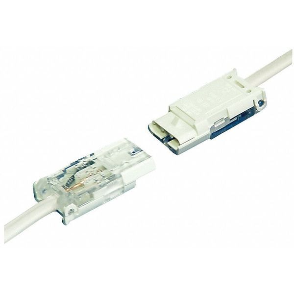

May have found the problem. Under the cabinet on the floor beneath the microwave I found this:
It is a Molex 19045-30 MOLEX SELF CONTAINED POWER CONNECTOR 19045-30. The yellow lead heads into the wall and I'm guessing up to the microwave. Sorry for the large picture. Is anyone familiar with these? Can I take it apart to test it - and put it back together again, or are these one-time-only-use connectors?

I realize you said what the factory told you about a direct run... but... some rigs with a microwave AND a fireplace have a switch or a relay allowing you to use one or the other but not both. Does your R/V have anything like that? Just wanting to cover all the bases.
Also... many R/Vs have electrical wiring runs made up in advance to facilitate speed in building them. They will often connect Romex wire with connectors like shown below. You may start looking for one of these...
Wow! While you were posting this, I was crawling around taking the cabinets apart underneath the microwave and found it. See my previous post. Thanks!

Web Page
Jim, here's the web page on that connector. There are several links from that page for specifications and drawings, and one for the special ratchet tool they spec for applying the connector.
Guess what? It's another one of those Insulation Displacement connectors that forks over the conductor, making contact at two narrow points.
I didn't see anything about removing the connectors, but I didn't try all the links.
I took one apart once (wasn't a Molex) and put it back together.
Even opened the hinged cover to test the wire connections.
The wires do clip in like the inexpensive outlets we see in R/Vs but the connector is made to mate (one connector to the other) more than once I'm sure.

Good start
They disconnect from each other? That's a good start. Jim can figure out which of the two segments has failed and only has to replace one of the two connectors.

Thanks guys. I'm going to give it a try shortly. I want to see if I can take it apart, test it and snap it bck together again.
