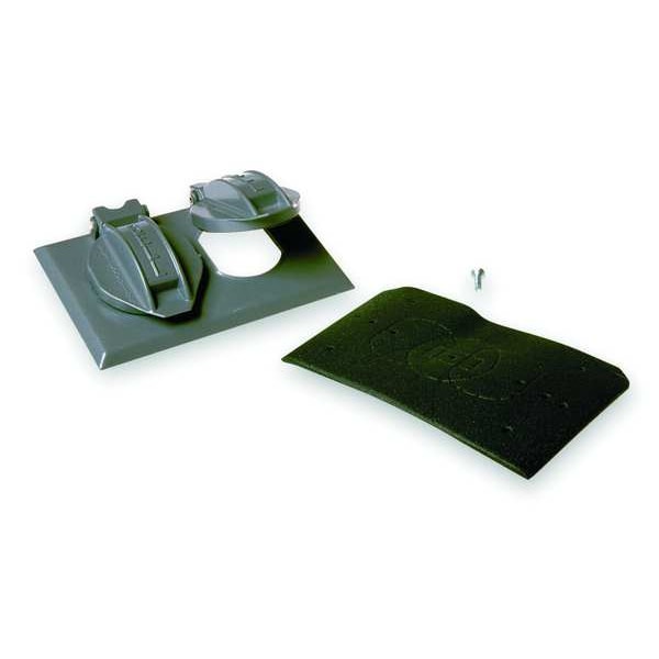

My previous TT did the same frequently and it also was the outside receptacle that was the culprit. The so called "weatherproof" cover wasn't weatherproof by any stretch of the imagination and whenever it rained, with wind, and the outlet got wet it tripped.
I looked around for a better outlet cover and found a die-cast one that had a really good gasket around each individual "flap". The plastic one the factory put on went where all other crummy devices like it end up, the dump.

That’s a good idea. Our previous rig didn’t have this problem and this one has been OK until this incident. Not sure a different cover would help if I have something plugged into it.
I ended up unplugging the Christmas lights and plugging them directly into the pedestal, so hopefully problem solved.
