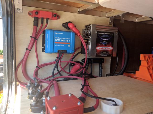

I think getting some busbars will help clean it up.. if nothing else, it'll help with some of the piles of connections I have different places.
Yep...busbars are good. Piles of connections are bad. I saw a professional installer put around 8 connections on a shunt once. He didn't understand why that was a bad idea. For example, Marine ABYC standards limit the number of ring terminals to 4 on one terminal post.
8?! Wow!
I'm unhappy that I've hit 3 or 4 for a couple of connections. It's just such a hassle to get it all screwed together. I had one ground connection that I was cursing by the time I got it all back together!
yeah...it was Brian Boone who thinks he's the best installer in the world and tries to dominate all the Facebook solar pages.
Get a good crimper, cable cutter and quality lugs and make your own cables. I have bought some lugs on Amazon but they are pretty thin for my liking. I like the ones from genuinedeaz.com the best.
Whatever you do, don't use a hammer crimper and don't use solder. Total rookie move.
Here is a picture of my busbars in my solar install. This is in my pass through. It folds up so you don't see it all.
Heh, yeah.. Brian Boone is quite the character. I know he's quick to argue and then boot people from his group so he stays right.
I will say, I'm loving your 2 layers of panels that you have things mounted to. I've got a variety of things that I need to install in my battery hatch and was worried I wouldn't have enough wall space for everything that I want to hang.
I used to have a panel there that all it did was shield the backside of the wall ac outlet. I mounted a piece of birch plywood to just cover that with aluminum angle. Used the same type of plywood to create the fold down piece.
Overall, there was no loss in room since the panel that was originally in there as a shield stuck out further than what I have now.
I also added some 5V fans, after these pictures were taken, that run directly off the solar panels through a buck converter. This keeps air moving since this is such a tight area. When my solar is cranking, there is some heat build up with out them.

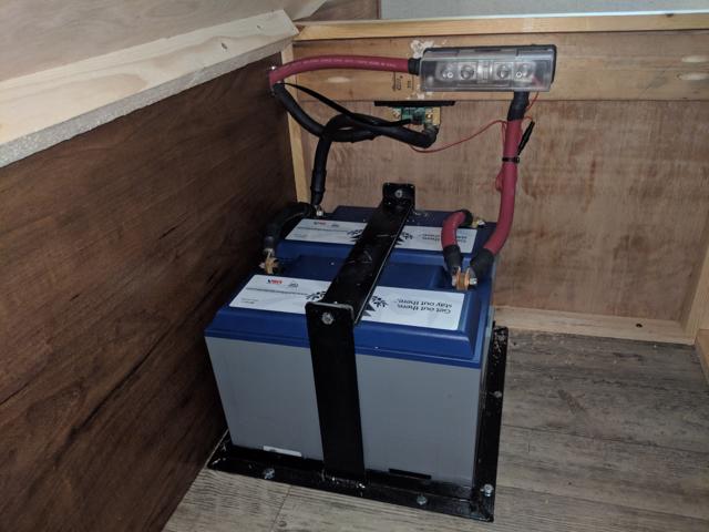

This is where the batteries are on the other side of the wall under the bed. VERY close to all the charging components and the inverter.

Have you seen the setup the Ray from has? He has a lot of things mounted on the back wall of the front compartment of his Cougar 5th wheel. I have to admit that I don't know much about solar so it doesn't take much to impress me on that subject. His setup may or may not be great.
He does a few things that aren't very safe there including no battery switch right after the fuse/batteries and no small breaker after the converter, otherwise pretty good.
It's good he puts the 200A catastrophic fuse right after the batteries. Only problem is that there are unfused wires after that that will fail way before that 200A fuse blows. Would be good to put a breaker leaving his bus bar going to his switch and then going to his house loads right after the bus bar. Even in my install, I violate that somewhat but it's a very short length before it hits the breaker.
It's good he actually ties down his batteries. I see so many installs where the batteries are just sitting there with nothing holding them down. I have seen installs with 10 or more battleborn batteries with not a single tie down.
Is this area vented to the outside??
These lithium batteries don't require venting.

Lithium batteries don't off gas and contain no liquid. They can be installed inside without ventilation and in any orientation you want.
Didn't see the label clearly enough.
