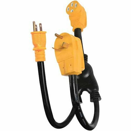

Couple things I have figured out. Most of the places we stay are 30 amps(COE and state parks and such) some do, but not many. I was told you can use a cheater adapter to tie in the 30 and 15 amp plugs...only 2 times I have tried it the GFCIs didn’t play nice in the sandbox.

Sorry to say most likely not. Some say you can if you install a couple of helpers to the units. If you use LP for the reefer and the WH you can MAYBE get by with it. Leave the micro off and no hair dryers when both A/Cs are on.

And as mentioned, the adapters that let you plug into BOTH the 30a receptacle and the 15a/20a receptacle usually trip a GFCI and most warn they will right on them.
