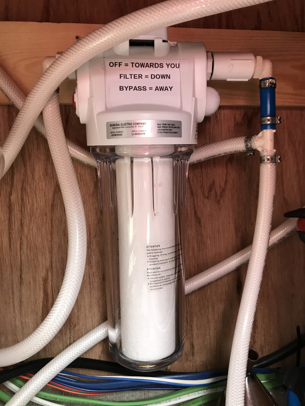

I just finished installing the GE GXWH20S filter in mine. I like the fact that it has a built in bypass valve.
I was surprised that it included a 90 day battery operated timer that can fit on the top of the filter or it can easily attached to any magnetic surface.
If you decide to put it outside make sure that you keep it out of the sun. Most of these units are intended to be mounted inside and out of the sun. The clear housing can be degraded by the sun.
Bob
So when you turn on bypass do you leave water in the filter canister all winter without antifreeze or is canister and filter removed?
It will be empty.
